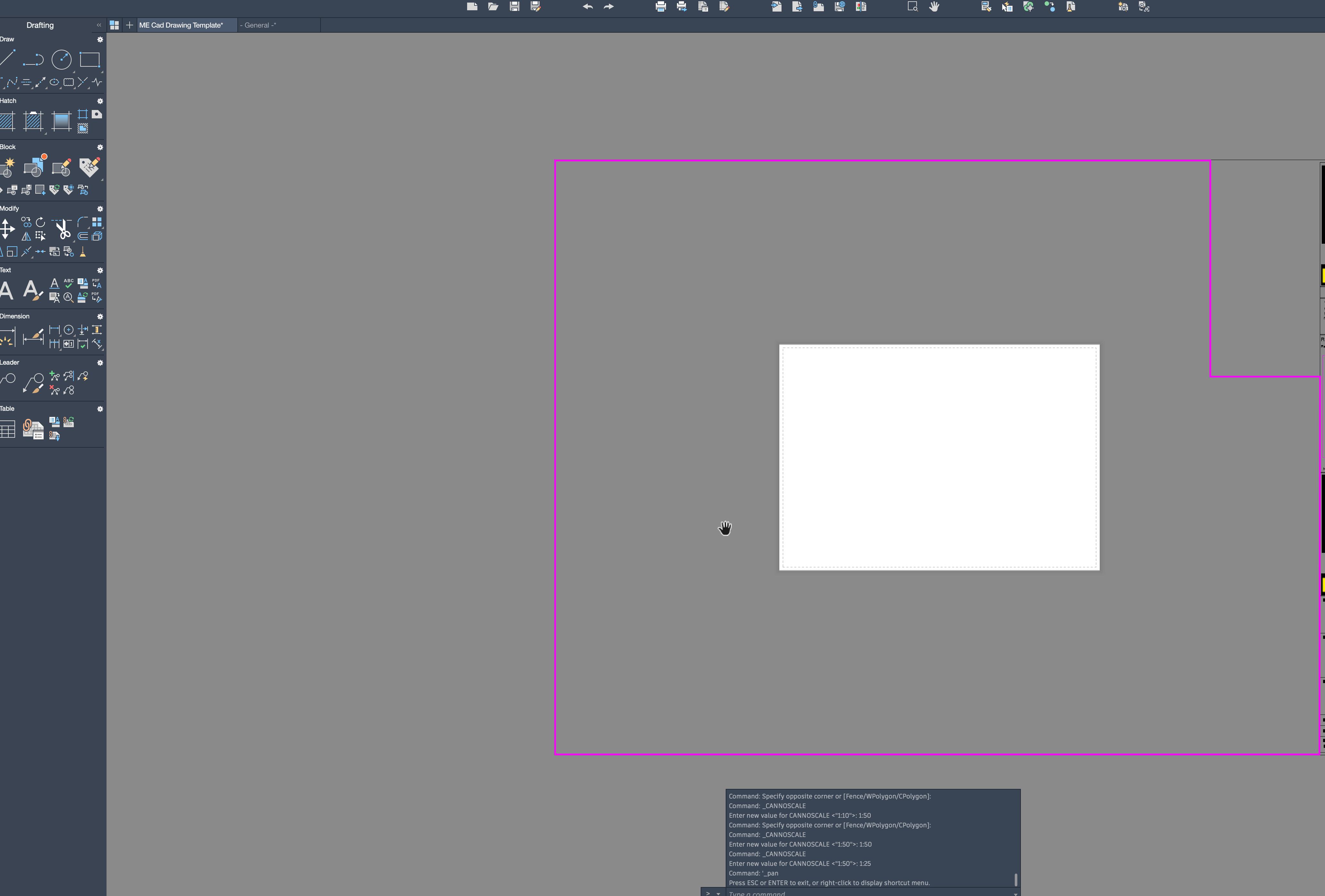

Hi I have recently had some templates set up on AUTOCAD lite for Mac.
On my A0 template the viewport shows the white piece of paper fine but on all the others it shows it in all different positions, everything prints fine but i would prefer it all white so i can see what i have in there a little easier.
Screenshot attached.

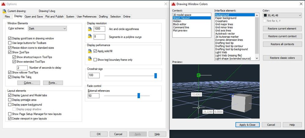

Not too sure where it is in LT for MAC, but in Windows at the command line if you type in OPTIONS and then click on COLORS in the DISPLAY tab you can change the background colour.
See the image below

Hi @Anonymous
If you are using AutoCAD 2021 for Mac you can change Paperspace background in AutoCAD Preferences - Look & Feel tab):
http://help.autodesk.com/view/ACDMAC/2021/ENU/?guid=GUID-B7D331D4-C973-4DB3-9345-65E928196885
