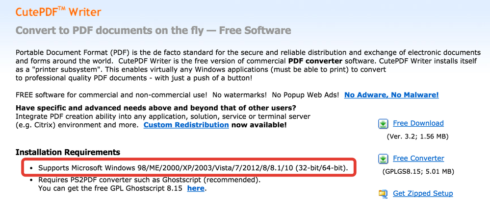

Yes CutePDF writer works in Mac! see attached.
I asked you about CutePDF on Mac because:

I cant answer more about Cutepdf but it seems to be installed on my Mac and prints quite happily.
