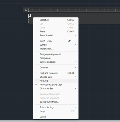

Hi @ihuynh1 ,
Do you use SHX based Text Style?
If so, then GREEKS.SHX and GREEKC.SHX font have Mu letter (latin "m" on keyboard)
If you use TTF based Text Style, you can insert special characters in multiline text with context right-click menu:
Maxim Kanaev

maxim_k
in reply to: ihuynh1
Hi @ihuynh1 ,
>>>>>but I still cannot use the Mu function as it still displays as a "M".
Uppercase Mu will show as "M" - check if Caps lock is turned on, when you type.
