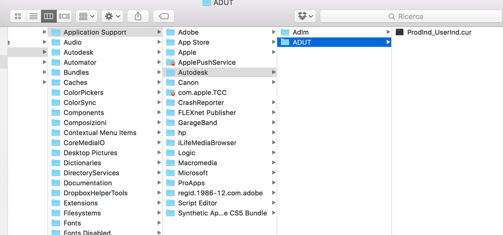

Hi
I have tryed to found the roaming sub folder in ton my application folder of autocad. I have attached a screen shot because I dont found the mencioned folders : Applications/Autodesk/AutoCAD 2012/AutoCAD.app/Contents/Resources or similar.
Where I can put the folder with .cui files ?
Alessandro
Schermata 2017-04-05 alle 09.36.54.pngSchermata 2017-04-05 alle 09.37.17.pngSchermata 2017-04-05 alle 09.37.26.png
