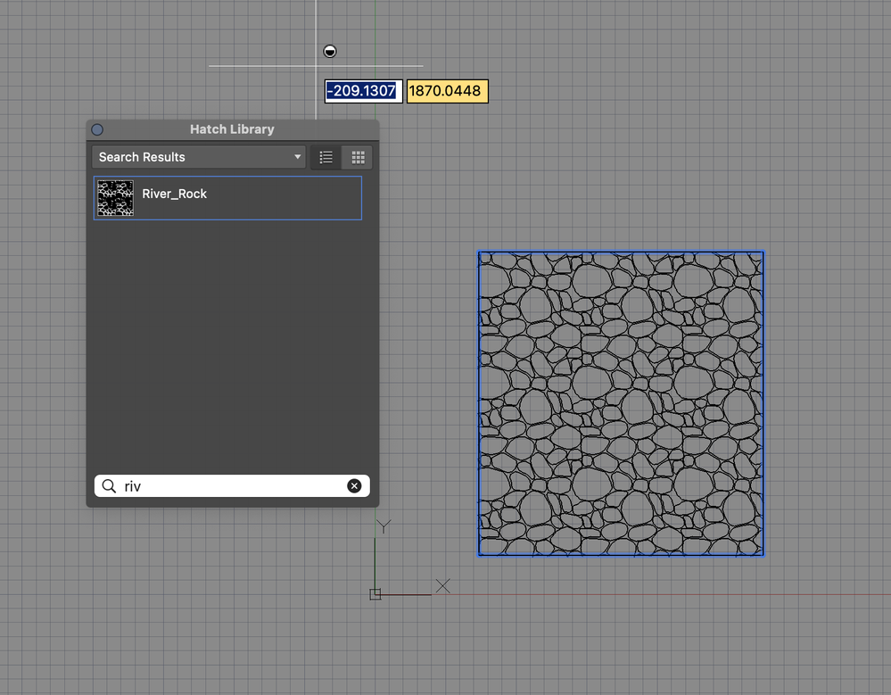

I can't get new hatch patterns to load properly. I've tried all the suggestions offered from a google search, but I always get 'error in reading the pattern file'.
I've tried user defined, and custom. I've removed everything from the first line of the PAT file, and made sure that the PAT file name matches the first line of the text file. I've added a hatch folder in the 'support files search path' under preferences. I've restarted Autocad after changes, and restarted the computer. I've tried PAT files from several manufactures, and generic onesI find with a google search.
Often a thumbnail image appears in the custom list, but I always get the error. I'm trying to get a stone pattern, and I've tried PAT files from several manufactures without success. I've attached a typical sample for review

maxim_k
Hi @NYSmokepipe ,
Now I can reproduce this problem.
Try this:
- Start HATCH command
- Use the button on the Hatch Visor to open Hatch Library window:
- Now find River_Rock pattern in the Hatch Library window and pick on it to make it current:
Now pick points (select boundary) in the drawing.
You may need to adjust Hatch scale to see the result.

NYSmokepipe
Interesting! I got this to work by following your screenshots. I've always used the dialog box, so I wasn't familiar with the hatch visor. I googled how to get it and needed to set HPDLGMODE to 0, then it appears when I issue the hatch command. Even though it works with this new way (which I will be using from now on) it still does not work with the dialog box way of doing things. Must be a bug maybe? I'm going to download the rest of the patterns and test this out. I've had this problem for so long -Thanks for your persistence in helping me resolve this.
