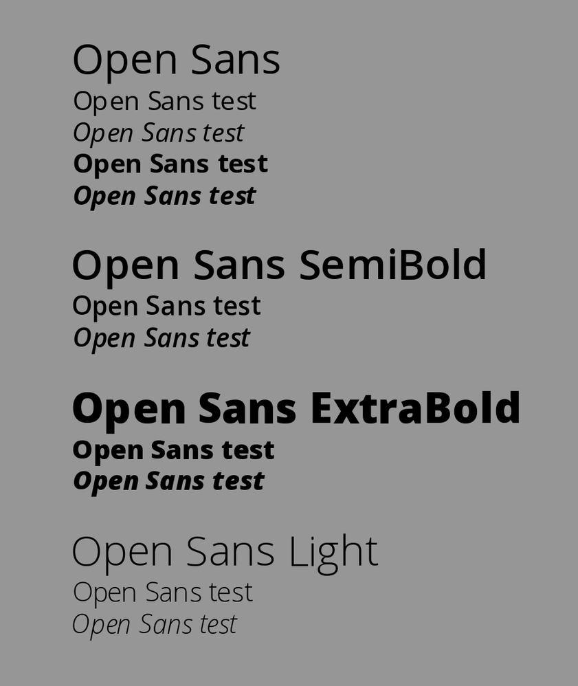

I modified google Open Sans font set slightly for my own needs and now I get such result:2019-01-04_20-51-50.png
Do you need the same result?

In the attachment you can find the set of Open Sans fonts adopted for use with AutoCAD for Mac.
But at first I have to say that it is not necessary to install fonts to AutoCAD application folder as you described in your initial post. You have to install them using Font Book app (or by coping them to ~/Library/Fonts folder - the Library folder in this path is inside your Home folder).
So before proceeding with installing my versions of Open Sans fonts you need to delete Open sans fonts you copied to ""Show Package Contents" > "Resources" > "Font" folder within AutoCAD".
Now you can unzip attached archive and install all fonts from it to your Home Fonts folder.
If you will look at Open Sans fonts in Font Book app now, you should see something like this:2019-01-04_23-58-59.png
 Open Sans fonts are split in four groups unlike the case when you install "pure" Open Sans Google fonts, which looks in Font Book in such a way:2019-01-04_23-50-33.png
AutoCAD for Mac cannot handle styles variations in this last way.
So, now launch AutoCAD and try to use Open Sans fonts.
On Windows side you can still use Open Sans fonts from Google without modifications and you will be able to exchange drawings between two platforms without loosing formatting.

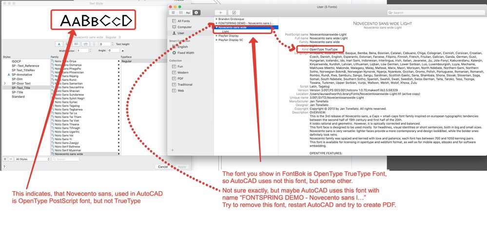

Nevertheless, I am sure that "Novecento sans wide" font has a duplicate installed on your system. Evidence of this is the presence of "Active copy" record at the end of the font path:
Plus, "Novecento sans wide" font preview in AutoCAD looks incorrect jn screenshot you provided. Isn't it?
Only postscript based fonts, shows in such a way in font preview in AutoCAD, I know this exactly.
Plus on the same screenshot you can see "Novecento sans wide" font in Font Book, which is correct font, but it is TrueType based font, not Postscript based which you see in AutoCAD:
The bottom line:
You need to remove additional "Novecento sans wide" font from Font Book. I think it is "FONTSPRING DEMO - Novecento sans ..." font - it is above the correct "Novecento sans wide" font.
If it is not it, then try to find incorrect font in other place - switch view in Font Book to "all Fonts" and look through the font list, it should be there.
After you remove incorrect duplicate of "Novecento sans wide" font, be sure to restart AutoCAD and test PDF output.
