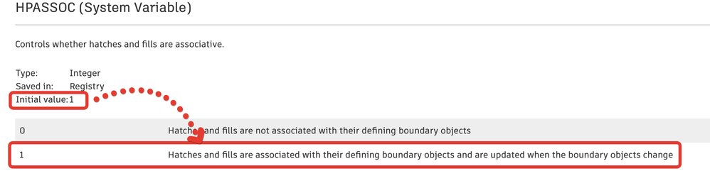

Hi @Anonymous,
@Anonymous wrote:
  1. Why on earth is associative hatch not the DEFAULT!!!!???
Associative hatch is default, look at the Help topic:
@Anonymous wrote:
2. Why is there not a toggle in the hatch dialogue box???
You can leave your feedback here:
https://www.autodesk.com/company/contact-us/product-feedback
For now the toggle is on Properties palette.
