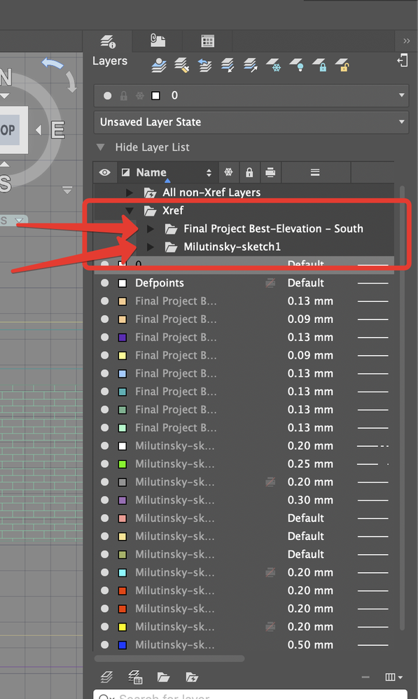

maxim_k
@Anonymous wrote:
Is there a way to group or re-arrange the order of Xref's so that its easier to toggle on/off?
Hi Tom,
 When you attach Xref, AutoCAD creates Layer Group for that Xref making easier to manage Xref layers:2019-01-31_09-22-41.png
https://knowledge.autodesk.com/support/autocad-for-mac/getting-started/caas/CloudHelp/cloudhelp/2019/ENU/AutoCAD-MAC-Core/files/GUID-8FBBD2EA-EE02-4D34-A82B-2F39AE34B40D-htm.html
