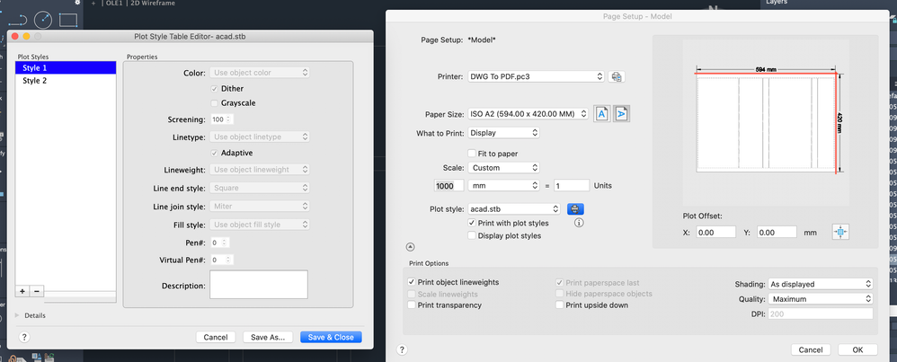

I'm using Autocad for a while, I'm understing a lot of thing about that program, but I can't get rid of an issue, it's gonna make me crazy: every time I draw something, when I plot to PDF I always find problems about which lines are in the front and which ones are in the back, so every time I have to go back to change them. But there is another big problem: the ends of lines are always above other lines (see the image, where the grey line is above the black one), so I try to change the end type (because as you can see it end as an arc). I change plot style and end line type as I read in 3/4 post around this forum but nothing changed. (as you can see there is also another problem with the little twisted column made of copied splines, but one of them, in the photo, is triggered!).

I'm using these settings trying to make the line's end square and not rounded. Nothing change, I tried a lot of times and I don't know what's wrong.

maxim_k
I think something is wrong with plot style table file you are using.
On the screenshot you provided I don't see Normal plot style, and this is strange, because in this Help topic one can read: "You cannot delete or edit the NORMAL plot style."
Looks like there is a bug in AutoCAD for Mac Plot Style table editor, which allows to delete Normal plot style from CTB file....
I tried to recreate your workflow on my side using newly created plot style table and was able to "print" to PDF with line ends defined in plot style table file.
So I recommend you to recreate CTB plot style table file from default one  - you need to find "correct" version, because I see you edited default acad.ctb file and it was damaged with AC for Mac Plot Style table editor.

maxim_k
>>>>>In STB I can't make the ends "square".
In acad.stb you attached line ends are square for plot style "Style 1", so you need to assign "Style 1" plot style to all layers in your drawing in layers palette or set plot style for all objects in the drawing to "Style 1" using Properties palette.
