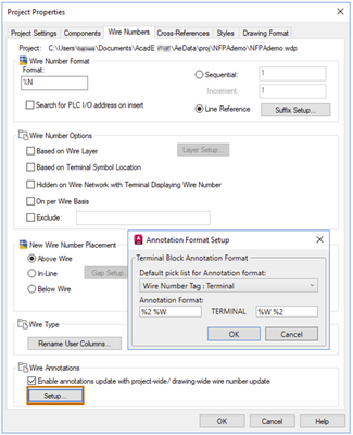

Hi all,
In AutoCAD Electrical 2026, you can now use project-wide or drawing-wide wire number updates to update the annotations in panel footprints and terminal block representations, including graphical terminal strips, tabular terminal strips, and jumper charts. This enhancement ensures that your wire number annotations in panel footprints and terminal blocks are consistently updated along with the rest of the project or drawing.
Refer to the below help topics for more information:
AutoCAD Electrical 2026 Help | Update Wire Number Annotations in Panel Footprints | Autodesk
AutoCAD Electrical 2026 Help | To Update Wire Number Annotations with Project-Wide or Drawing-Wide U...
