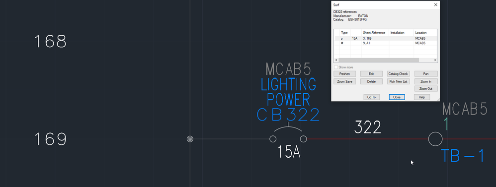

I use both 2021 and 2018. In the screenshot below, schematic has line reference and panel drawing has x-y grid refs set. Both show sheet and references. This is not for parent and child but this should work for parent and child as well.
