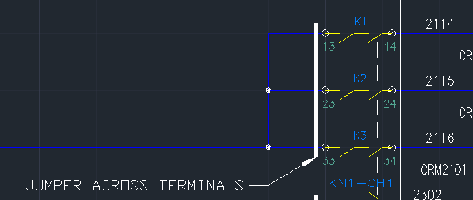

I have a question on this topic.  The screen shot is how I show a jumper on a safety relay in the schematic.  The 'jumper' is a smart symbol so I can add all the mfg. / cat. / name / number of positions etc. info to have a good bill of material count for number of jumper for the panel build.  Can this smart block be worked into the 'jumper layer' feature?  I guess I am thinking along the line of a 'smart wire' that has all the component info as well as connecting wires and carrying wire numbers over termination points.

I think that if you open the block in BlockEditor or SymbolBuilder, you can just set the object to be on a JUMPER layer. However, it doesn't look like a line in your image, it looks like a polyline with width. If that's the case, it won't matter because ACADE won't see it as a wire anyway. (Only a LINE can be a wire...not polylines or arcs.)
The whole point to putting wires on a JUMPER layer is to prevent them from appearing in a report, such as wire from-to lists. Since your smart block isn't a line, it can't be a wire, and therefore won't appear in a report.
If by 'smart block' you mean 'dynamic block', it's not likely that you'll be able to get it to work with wire numbers, etc. owing to ACADE's general inability to use dynamic blocks.
IMO, the way you're already doing it is probably the best. You graphically show the jumper in a way that gives you catalog info for your BOM, all without screwing up the function of the schematic. Unless you need to generate clean from-to lists, or some other report, I think you're already good to go.
