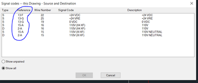

No exactly. Let me show you with some screenshot because my english is no really good:
The reference is an integer number, so the cross reference appears (sheet-reference):
I want this format (sheet-arrow-colum) :
I have tried a lot of things but maybe, there is something that I am missing.
Thanks you all!!
dougmcalexander
Normally for IEC, the columns (X-zones) are numbers, not letters.  But I have seen some use of a combination of X and Y zones, with the Y-zones being A, B, C, etc.  The software allows for that. You set it up that way in the Drawing Properties>Drawing Format tab.  The border in the sample drawing I posted previously has letters down the sides, but I did not use them in the formatting.  I could have though.  If I want to include the Y-zones, I choose the X-Y Grid option.  (see screenshot).
The cross-reference format I use for IEC is /%N for the same drawing and /%S/%N when the cross-reference refers to a different drawing.  (see screenshot).

ernesto_ramirez2105
Thank you, it works. I am grateful with you.
