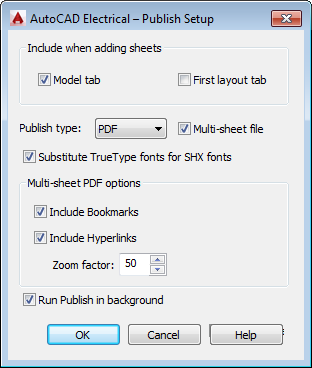

Hi rhesusminus
Where do i find the 'font replacement' option while publishing to pdf?
Message 7 of 11
rhesusminus
Substitute TrueType etc.

Message 8 of 11
The issue is even worse when i do that. please see the attached multisheet pdf file which i got after unchecking 'substitute true type...'.
And, i always use the 'batch plot' option under print menu (see attached screenshot - batch plot.png) instead of using the publish to pdf icon in the project manager tab. Not sure if that will lead to any difference in the print quality.
Also, I just noticed that the plotted pdf file is opening fine in Foxit Reader. The issue with the faded print is only with Adobe Acrobat. Now, i am wondering if the issue is because of problem with Adobe Acrobat or AutoCAD electrical.
