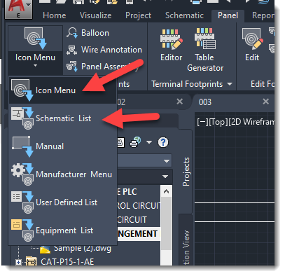

If you have drawn the schematics AND assigned catalog numbers there, you should be able to use the "Schematic List" to pick what components to insert.
As the enclosure isn't drawn in the schematic, along with din-rails and cable ducts, these are inserted using the "Icon Menu".
There WILL be a lot of components that you won't find in the catalog that comes with AcadE, so you should learn how to add those yourself.
