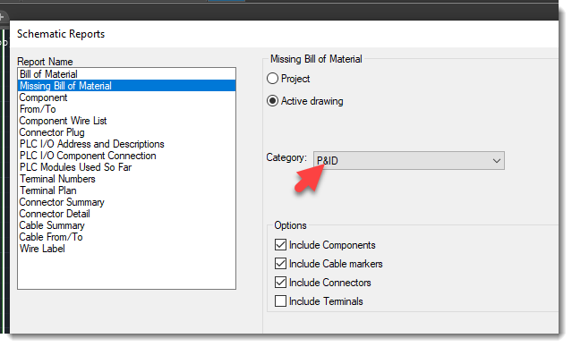

I made a P&ID drawing for a coworker to help him set up some pneumatic equipment. I thought it would be helpful to tabulate component tags, part numbers, description, etc. so he knows the components' weight and dimensions. But I keep getting the "no data to display" error message when I do the schematic report. Please advise. Drawing attached.

Do you want to get a BOM?
You must assign MFG/CAT to get that.
An... You must select "P&ID" in the category dropdown...
If you do a "missing bom" you get some data:

Thanks for the feedback. Yes I want to put a BOM on the drawing. I assigned MFG/CAT data for components, and picked P&ID. Still getting the "no data to display" error. I have read through some of the older ACADE posts and it seems like this is a prevalent error that has troubled a lot of users, with incorrect installation being the most common cause. Updated drawing attached.

I just us schematic buy looking at your drawing I noticed I didn't get any data to show up until I selected pneumatic.
