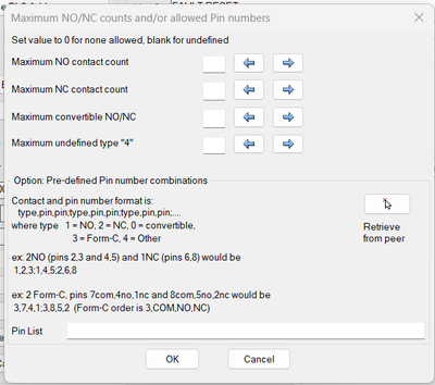

Good morning all,
On multiple projects, I've tried to use relays with Form-C contacts.
The issue is that no matter what Form-C relay I use, the Form-C pinlist won't populate:
Anyone have any thoughts?

I just tested, and it works as expected.
This only applies to Form-C contacts?
Is there a secondary database?

There isn't a secondary database, but for some reason, the pinlist isn't populating on the part correctly, even though I always go and link the part to the database.
When I went to the pinlist on the part itself, it shows up blank. Not sure, but it looks like part of my database isn't linking to the parts. 😞

Can you try to replace your database with the default one that comes with AcadE? I see that you open it in Access, so there might be some issues that has happened there.

Did it work with a fresh copy of the default_cat.mdb ?
