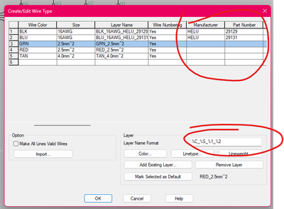

I have a custom symbol that I have created in AutoCAD Electrical 2025 that is a "cable marker" that I am using as a wire marker (name of symbol is: Hw01-WIRE -- attached).  This is the only logical way I could figure out to be able to assign a part number to the actual wire itself.  Upon creating this symbol, I put in the WIRENO attribute and hid all the other WIRExxx layers with the idea that when placing this marker, it would either be blank (meaning it is an indication the wire number has not been assigned) or if the wire number was assigned, it would automatically grab that info to display.  The issue is that this does not happen.  What happens is the X4TERM01 and X1TERM01 connection points grab the pre-entered wire number, but the WIRENO attribute does not.
If I click the wire and grab the blue sticky and take the wire off the wire marker connection point, and then do a stretch wire command so it builds itself back into the same connection point, it is like the database refreshes or something and the WIRENO info is there.  Another way to get the WIRENO attribute to populate is to do an EDIT WIRE NUMBER command, and then just press OK (without changing anything). Another way is to just have the wire number undefined when I insert the wire marker symbol, and then assign after.  However, this also is confusing because if I do a COPY COMPONENT, it will keep whatever the old WIRENO info is, until I do one of these manual processes to make the software refresh the WIRENO attribute.
If this makes sense, I would love if someone could give me ideas on either how to do this a better way, or why the way I have done it seems like a bug in the software.

The general idea with AcadE is that you should put this in the Wire Types. In the project properties, you can rename the user columns when configuring wire types.
Then, when creating wire types, you can do something like this:

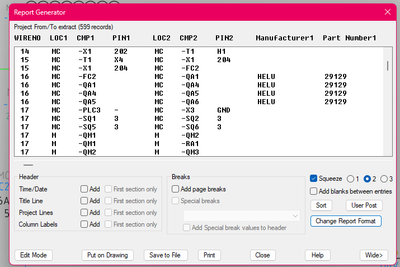

When using these wire types in your schematics, you can now extract that info in the from/to reports:

@rhesusminus --- this is awesome! thank you so much for this!   couple of follow up questions... is it possible using this method to extract this info on to a BOM report? If so, is length (quantity value) something that can be added and then added up for all the same wire types in a location?

The answers are mostly no.
