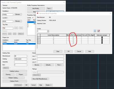

I guess I need to be a little bit clearer in my question. I made some assumptions that don't seem to be working.
1- See attached Terminal Block Properties.  I assumed that once I put the internal jumpers across all 4 levels that I would need to  insert 4 terminals and then associate them by using the pick or add modify.  I would have 4 terminal points on my schematic but only using one terminal block.  Based on what I have seen, it is best to insert one terminal block symbol with 8 wires (2 per terminal, 4 terminals per block) and just bring the wires to that terminal block symbol.  I guess that I really do not understand the associations?
2 - Internal and External connections.  Here is another assumption that I made.  I assumed that these connections pertained to the internal terminal block connections.  The external would be the bar that would connect terminal blocks.  Example - power or common terminals.  Use jumpers to go across.  Thought this would be an external connection.  Would this be an internal connection?  External connections go to something that are not in this panel. Example - panel to field wiring.

From what you describe, I think your best approach might be to edit the record for the part number and designate it as a 4 level terminal.  Then you can insert 4 terminal symbols and assign each as one of the 4 levels.  The level assignment can be made easily in the Terminal Strip Editor.  Connect the terminal symbols to one another on the schematic with a wire type named JUMPER.  Since the terminal had an internal jumper built in to do not need to use the Edit Jumper utility to assign a part number for the jumper.
Internal and external refer to where the wires connecting to the terminal come from, another device inside the enclosure or a device outside of the enclosure.  You will also see this depicted in the Terminal Strip Editor.  You can also make the internal or external assignments in TSE.  I find it easier to create multi-level associations and internal/external assignments in TSE.

Using this circuit as an example
If I set the wires per connection to one.
I get an extra terminal that messes up the footprint but the tab layout looks readable (besides the extra terminal)
However, if I set the wires per connection to 2
I do not get the extra terminal, but the table is rather confusing as it has 2 lines per termination point.

Are there four terminal symbols in the schematic? We can only see two.
Are the terminals in the schematic associated with the Associate Terminal tool? They should be.
Also, the phrase 'wires per connection' should probably really say 'wires per level'. ACADE doesn't know how many screws/connections are on the terminal, just how many levels it has. A standard feed-through terminal always accepts two wires per level. Where I work, we often use double ferrules on terminals, so I have to set my 'wires per connection' to be 4 because that's how many wires I could potentially have on a level (two wires per terminal screw).
As far as the grid showing an extra line, I guess that comes down to what you're used to seeing. My grids always look like yours and I don't find them confusing.

Yes only 2 terminals shown but its setup like a 4 pole terminal block as shown above in this forum string.

I think the problem here is a matter of terminology.
Looking up the assigned part number (AB 1492-L4Q-B), it is a SINGLE level terminal with 2 spring connections per side.
See This Data Sheet - https://configurator.rockwellautomation.com/api/Doc/1492_L4_L4T_L4Q_Spec.pdf
Here is a photo of a Multi Level terminal with 1 spring connection per side for each level.
You can see the difference between the two right away.
Multi Level terminals come in all sorts of internal connections.
Feed through - Isolated levels as per the photo
Feed through - Linked levels
Feed through - Isolated with LED
and so on.
So for your example strips using the single level block, everything is correct.
For a multi level block, you would insert each level as a separate terminal and then Associate them using the Terminal Sub Menu from the radial menu or the TSE. Note that to do so, you must have assigned a part number for a terminal that has multiple levels set.
