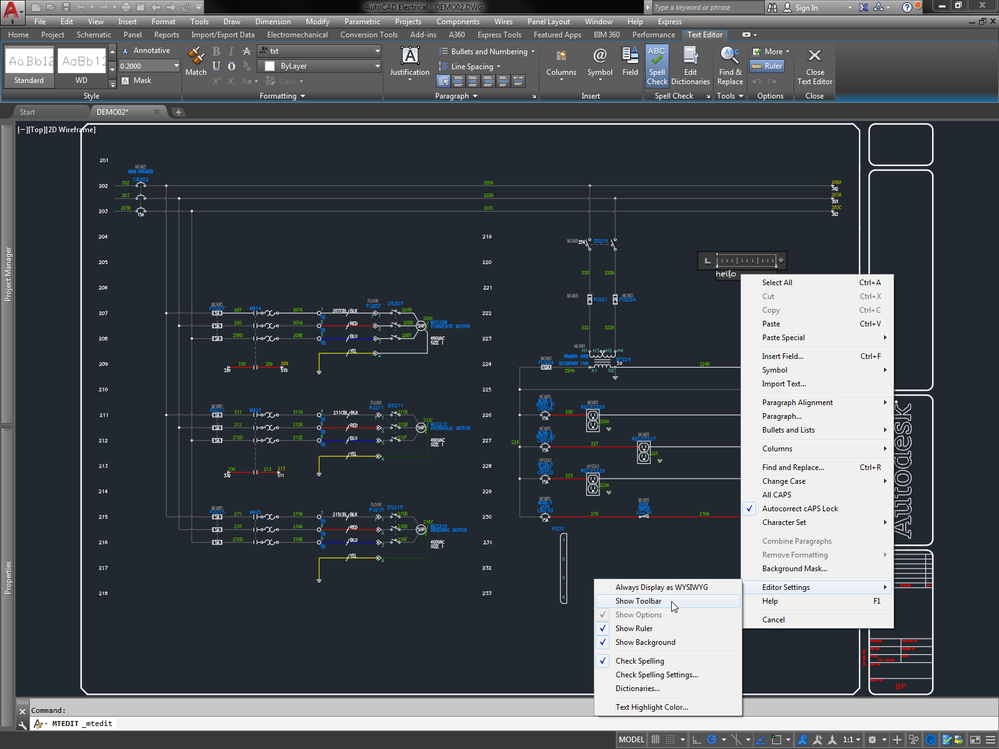

I have just updated from 2013 to 2017 and am not able to change a long string of cross reference line numbers to multi-line.  I am working with a project that was created using 2013, and the text was multi-line then.  Do I need to do some kind of project update?

Hi there,
Is this what you are looking for?
Good luck
Please mark as a solution if this works for you, kudos are always welcome
Message 3 of 8
TRLitsey
Or to say it another way ...

TRLitsey
I am not clear on this.  Are you just trying to resize area or edit the text?  Is your full tool bar for mtext edit open?  To turn the tool bar on right click in the text box to open the dialog.  And if it is just the box, to you make the size change and then click outside the box?  If you do not exit the editor correctly it will not save the edit, just go back to what it was when you started.

I think I understand what is going on here.
When you first change xref text to mtext, ACADE does so without any adjustments to the size of the text area. It will remain the same visually until you do the following:
1. Click into the text as if to edit it. You will see a box around it that represents the text's 'area'.
2. One corner of that area will have little arrows for resizing. At first, they are right on top of one another. Grab one and drag it over.
3. You should now be able to see the hash marks on the ruler, if it's enabled. If not, you should at least see some distance between the arrows. You should also see the text respond accordingly as you drag back and forth.
4. Set it up the way you need it and exit out of the command. Now click on it again. As if by magic, the normal mtext grips are now the way you are used to seeing them. They weren't there before because they were geometrically coincident with each other (meaning they shared the exact same coordinates in space). Their coincidence also prevented you from resizing with the grips.
