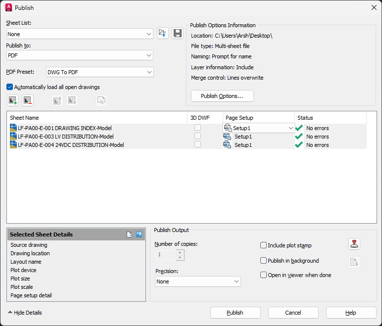

arshdeepsingh404
Hello @russell_bumfordDGN6N
Check out the settings I used and attached PDF results.
Batch Plot (PUBLISH)
Single Page Plot
The results look pretty similar.
One thing I did change was to set PDFSHX to 0, This can sometime leads to light liveweights and SHX text comments in PDF.
