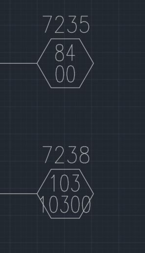

Hope someone can help me solve my issue.
I just updated my AutoCad Electrical from 2022 to 2024 and I'm having issues with my Hexagon Source and Destination Cross-Ref. Originally when setting up my cross-reference in 2022 it was using set-up as %S%N for both and the x-ref for the hexagon would still only put the sheet number on top and the rung number under, as shown in image below. Now that I started using 2024 all my source and destinations when updated from the previous version now includes the sheet and rung for the x-ref, as shown below. So, I was trying to get it to go back to how I wanted it to be sheet on top and rung on bottom. So I went back to my properties and changed the cross-reference to %N for both and it worked, but it interfered with my component cross-reference settings and now it only shows the rung number and doesn't include the sheet. I have shown images below as well. Is there anyway to fix this on my end so the x-ref only shows the rung number for my source/destination hexagon without affecting my component x-refs? My reference properties are set-up for sheet and numbers. I would like to keep my number base set for 00 thru 99 only and use my sheet as the first position when creating my ladders. example 100, where 1 represents the sheet and 00 represents the x-ref (line number).
How do I get my reference to look like the top view as it was in 2022 verses now in 2024 shown on bottom.How do I get my reference to look like the top view as it was in 2022 verses now in 2024 shown on bottom.example parentexample parentexample childexample childmy settings that would work with 2024 but interferes with my component cross reference. as shown in images.my settings that would work with 2024 but interferes with my component cross reference. as shown in images.

Hi @christina_humphrey ,
This is a known issue in ACE2024.0.1. It has been resolved in ACE2025.0.1.

Hi @jed43243
Please install the latest updates for AutoCAD Electrical 2025.  Then it will resolve the issue.
