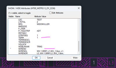

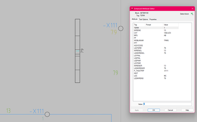

rhesusminus
It works as expected in 2026 also:
I had to do the "list/edit" attributes to display the correct information, as AcadE thinks you are using EITHER wire numbers OR terminal numbers, and will "turn off" one of them automagically.
