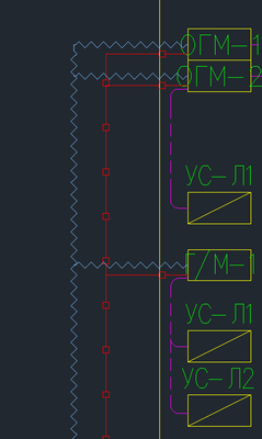

Some of my wife layers changed in shape that i choosed in all my drawing file.  i choosed zig zag linetype but it changed into weird shaped wire layer how can i solve this please help me?

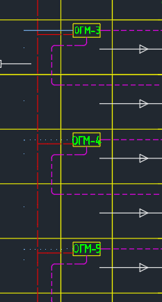

but i looks like thisbut i looks like thisbut i looks like thisbut i looks like thisbut i looks like thisbut i looks like thisit should looks like thisit should looks like this

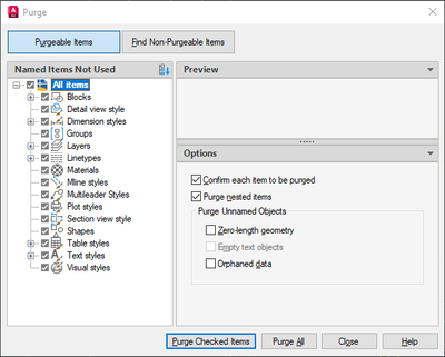

I was able to get the Zig Zag LineType working. Try the following steps:
1. Open drawing
2. Run the PURGE command and purge all items till there is no else left to purge.
3. Save drawing and close AutoCAD
4. Relaunch AutoCAD and open the drawing again.
See the following article for more details on this issue:
