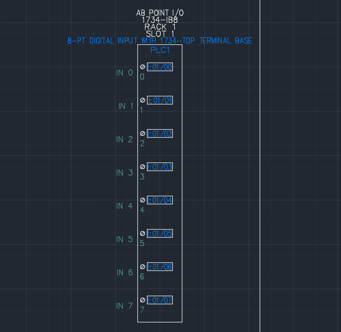

I am trying to find a block for 1734-TOP. I'm wiring a 1734-IB8 into a 1734-TOP. I am looking for a legitimate icon to use for the drawing package being created. I haven't been able to find one in the catalog browser so I'm wanting to see if anyone created one of these and would be willing to share or if there are any suggestions on an accurate way to build this block.

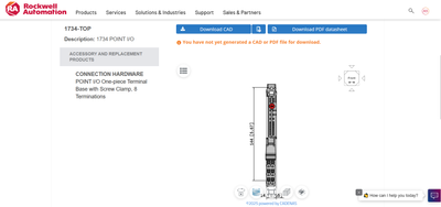

If you don't already have the AB Product Drawings website bookmarked that is where you will find your AB drawings from and the 1734-TOP is available in both 2D and 3D.
https://www.rockwellautomation.com/global/support/drawings.page

You don't need to show the TOP by itself in the schematic; it gets combined into the overall symbol. For a good analogy, consider one of those 'ice-cube' relays that plugs into a DIN-rail mountable socket base. In that instance, you don't represent the socket and relay separately. This is because there is no actual wiring between the relay and the socket. It plugs directly into the socket and electrical connections are made that way.
Same thing for the  1734 terminal modules. They're just a base (like a socket) that accepts the I/O modules. All wiring goes to the terminal module, rather than to the I/O module. So, schematically, there is no way to actually represent them separately.
The 1734 stuff all exists in the parametric PLC database. See my attached images.
First is a detail drawing, but it's made from a layout drawing. It shows a 1734 Remote I/O rack. These footprints were assembled individually, meaning the 1734-TOPS is one footprint, the I/O modules are their own footprints, etc. (No subassemblies.)
Second shows a 1734-IB8S module in a schematic. (Safety Input module) Note that the terminal designations in the PLC symbol correlate to the terminals on the 1734-TOPS. The whole 1734 line is set up that way, because you can't use one of the 1734 I/O modules without a base, and all bases are numbered the same. (For instance, we use 1734-TOPS, which has spring terminals, and you use 1734-TOP, which uses screw terminals. But the wiring is the same, and the terminal numbers are reflected in the PLC.
Third shows a pair of 1734-IB8 modules. Note, the same terminal numbers. Also, note that there are other things like a CTM, FPD, etc.
These schematic blocks were all made with the parametric PLC tool, even the CTM and FPD. These are part of the normal ACADE install, so you should have them as well.
However, if you mean to construct a 'fixed' PLC block, my advice would be to do it the same way they do the parametric ones: integrate the terminal module into it.

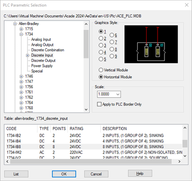

The 1734 series is available in the Parametric PLC selection.
Use the command AEPLCP and browse to 1734-IB8
You can download the 1734 series footprints from Rockwell's website https://configurator.rockwellautomation.com/configurator/1734-TOP/summary
