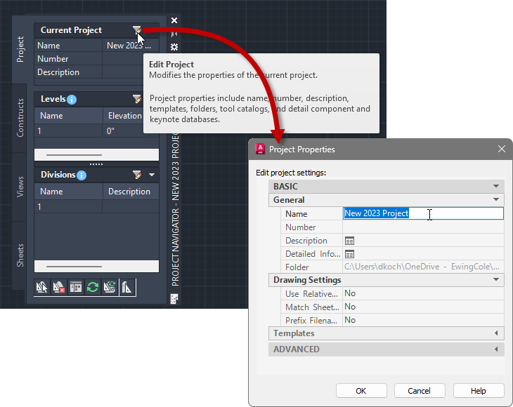

I like the project navigator, I've included a Screenshot, I can't configure the Name, #, etc, nothing will allow me to enter anything.  This looks like a good option for what I'm trying to do.  Also for external walls how would I make a level with second floor walls and walls that are two stories tall.

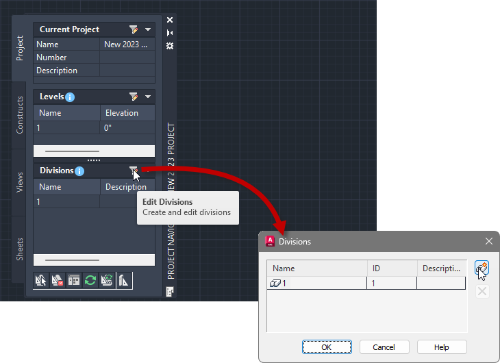

@cadwork12
To edit the values shown on the Project tab of the Project Navigator, select the icon that looks like a funnel with a pencil in the header of each section to open a worksheet where the properties can be modified.
