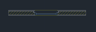

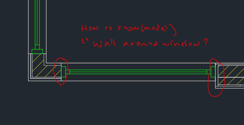

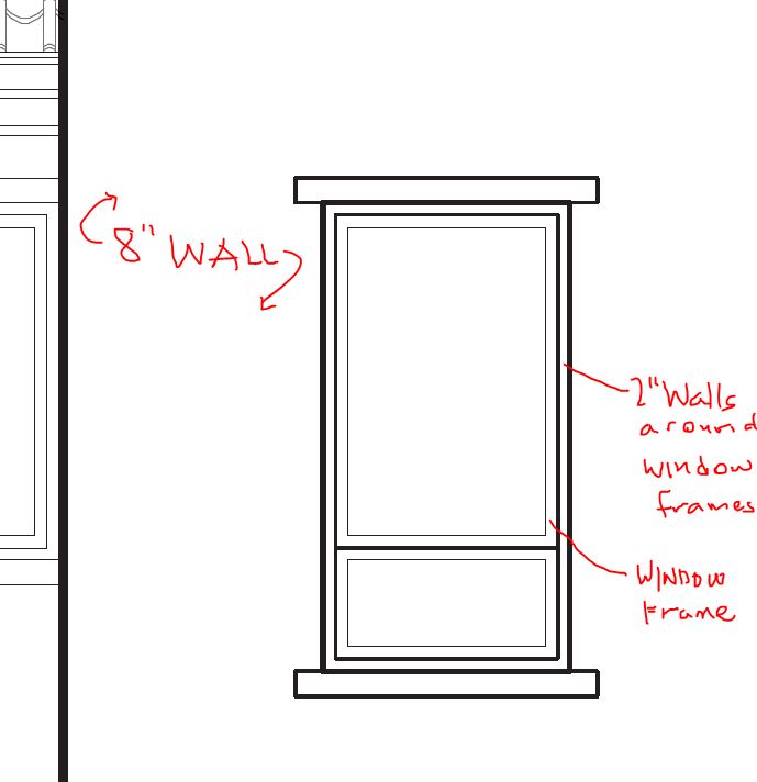

I would like to insert a window style in a wall thicker than the window frame AND to create a 2" wall around this same window frame.  Attached is an image of the condition from plan and from elevation. We have easily created the thick walls we need but we do not know how to create this condition in our ACAD Architecture model?  Any suggestions would be greatly appreciated. I have tried modyfiny the profile, but, I am not getting any results. Anytime I modify the profile the shape of the window changes without achieving the effect I am looking for. Again, suggestions would be greatly appreciated.
Here is the window in plan:
and here is a view in elevation:

and here is our model view in acad architecture:

You need to create a window opening end cap style.
E.g. right click the wall, select Encaps > Edit in Place.
Save the endcap as an opening style that you can apply to each window (or door)

@leothebuilder's suggestion was a good one.  Here is a 2013-format file (will open with ACA 2013 and later) with a Wall, Window and Wall Opening Endcap similar to what you show.  I doubt it is exactly the Wall you want, or the Endcap, but it does show that it can be done.  I created the Wall Opening Endcap Style (and the underlying Wall Endcap Style) by using the Endcap Edit in Place tool on the Wall contextual ribbon tab.
