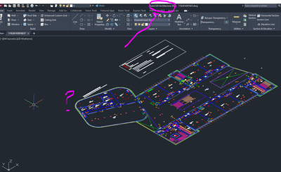

This is your posted file (which is missing XREFs) in AutoCADARCHITECTURE
This is the same file in DWGTRUEVIEW (the free viewer)
They do look identical to me, what are you seeing?
If you see anything missing, it's might just probably the two missing XREFs you may have forgotten to share with your viewer laptop most likely?
I'm not sure what you mean about 3D vs 2D, there is nothing 3D in the file you shared here in AutoCADARCH, so no 3D in the free viewer either

amber_newmanGLBKU
sorry i posted the original file
the one im trying to send has added halway strip lighting
when i send it i get the same as you saw minus the strip lights that i added
if you click 3d in viewer they appear there but not on the layout dwg
added below thanks so much for your time
