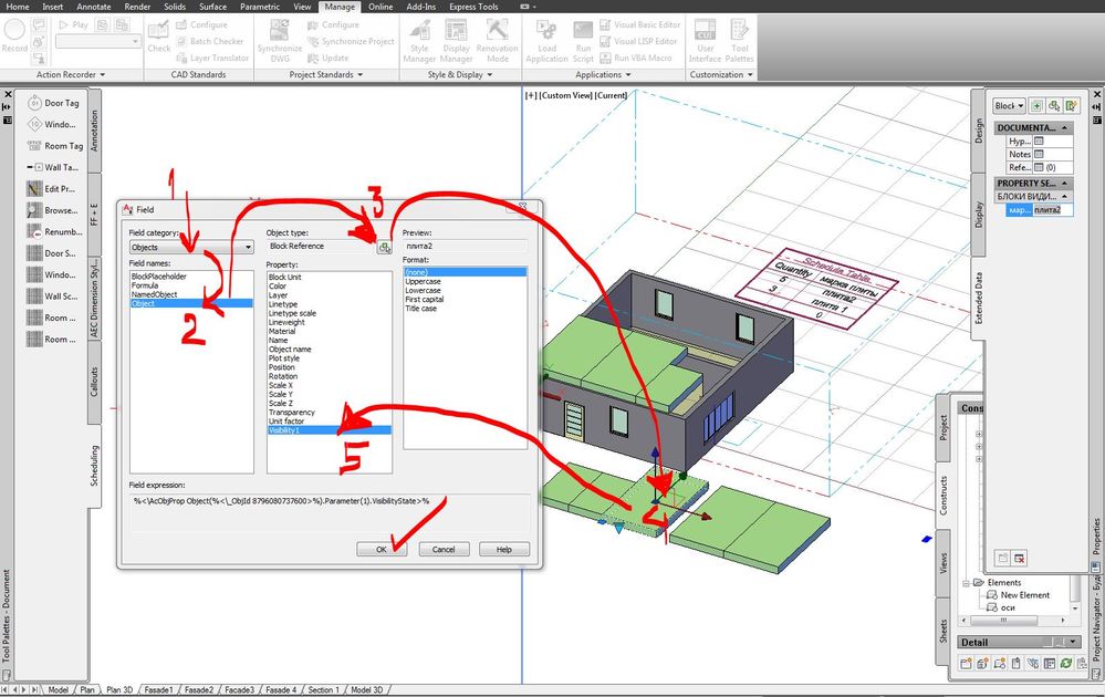

4 I saved block and went to "Property set definition" >created new and applies it to "block references" .Then in "definition" tab I added manual property.
5 Next task was the addition this new property set to the block . In the property set that appearse in "extendet date" of block I inserted field , and put out the date of "visibility" property.
Now changing of visibility's parameter of block can be depicted in "extended date" property in "property set definition"
By the way....it seems that "field" stucking , because after changing of visibility it does't changes instantly in "extendet date" . No panic! schedule react instantly 🙂
But just in case push ctrl+s. To check is everything works okay.
