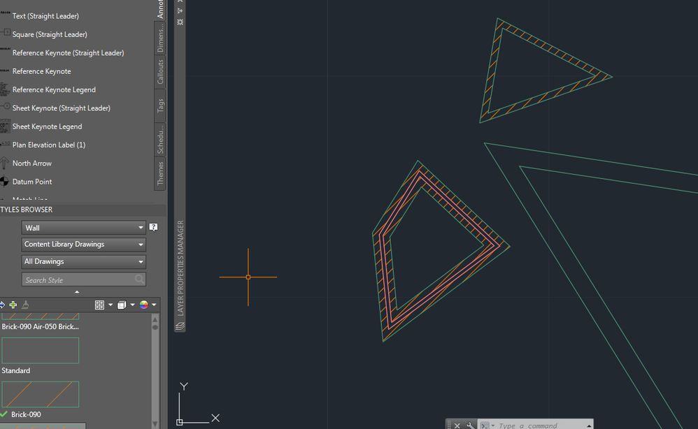

I am missing the hatch pattern for the standard wall.
I create a new drawing and the standard wall has no hatch, the others seem normal.
Also i received a drawing with the message "created with non-autodesk product" and parametric walls do not show hatches there either
I saw a similar post resolved before but it seems to have dealt with a different issue
I've attached 2 images, in the first one you can see several types of walls, but the standard has no hatch,
In the second image is the file i received where the wall has no hatch either.
thanks for the help!

The reason is standart material or hatch is off
first you need to check what the material applyed to every wall component..than if it applyed check is it plan hatch shown. If it is ok, then just chek the scale of hatch5657.JPG
also the display config. affect to it. For every display config. could be applied different hatchs display config"medium detail", "hight" detail"///etc

@Tiana_Y @brian_adams  wonderfully clear explanation, i followed the windows and found the solution, for some odd reason in a new document the default setting for the standard wall has the hatch OFF in plan view. but now i see where to turn it on for when that happens. Thanks so much!!
