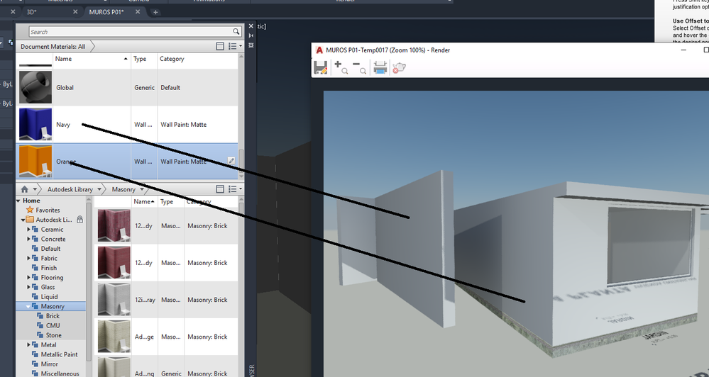

Hi
In acad 2020 i have a problem with materials, when i render my wall appears white, no matter which material i applied.  I tried in new file and with standard wall style, but the same result.
The problem is with all type of materials, with or without textures (wall paint for example)
But if i use the style browser and load other styles like external brick, the textures appears and render fine only in this walls.
Any idea?
Thanks.

Richard.Vivanco
I tried editing my wall style and applied the material in the components, right now it works fine.
But when i try to apply the material, dragging or with righ click assign to selection, teorically it apply but in the viewport and render appears the material that i assing in the component.
How do you apply differents materials to the walls without creating new styles or components.
In autocad you only drag directly to the solid and works fine.
Thanks.
Richard Vivanco V.
Arq. BIM Manager + Autodesk Certified Instructor
Website | Youtube | LinkedIn
Richard.Vivanco
Hi... sorry i found the solution.
The standard material was override , in the surface render material option i put NONE and right now i can apply differents material.
Off course it only works with standard wall style, in my wall predomin the material that i assign to the component.
