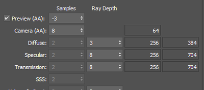

Please tell me, the rendering depth is set as shown in the picture, but the final rendering bubble still appears black, is the transmission depth not enough?01.jpg02.jpg

peterDTE7K
with GPU you need to dramatically increase specular ray depth to fully get rid of black patches on transmissive objects

Thanks for your reply, I tried again to modify (crank up) the render depth, but the result still comes out with black artefacts on the projected material, as shown.01.jpg02.jpg

peterDTE7K
You need to increase specular ray depth not transmissive ray depth. Sorry I wasn't clear - 48 transmissive is way too much and the amount you need depends on scene, simple bubbles don't need such high amount.
Try this:
Increase specular ray depth to 20 and set transmission ray depth to 20. If it fixes your problem then decrease those values until you have result which you are still satisfied with.

Thank you very much for your careful guidance, I tried the GPU model under changing specular to set to 2 and 32 respectively and transmission to set to 48 and 32 respectively. is that they give me the same result in the output graph display.01.jpg

wernienst
Unfortunately, I don't have an Arnold licence for Cinema4D, so I tried to recreate your scene in 3dsMax as close as possible using the geometry provided and Tyflow for the bubbles. I get this:
Here are the Render Settings:
I've also added a Denoiser Oidn Imager.
