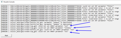

I have an issue with arnold and/or solaris when I restart a render.
(view in My Videos)
This issue appears when I want to visualize the Pref AOV, when I work with multiple uv sets (when I restart, Arnold maps all my image on the first/default uv set), etc.. I guess the same problem can be found somewhere else.
In my Houdini Console I have this kind of warnings
I don't have any problems when rendering with kick, only inside Solaris.
Is this a known issue ?
I'm using Houdini 19.5.682 with HtoA 6.2.3.1 (Arnold 7.2.3.1)

Stephen.Blair
Works fine for me with the latest HtoA.
Of course, your super-simple setup could be different than mine, since there's always different ways to do things in Houdini. But I've got a Pref attribute and two UV sets.

cedric_nivoliez
There it is.
So, when I start rendering and watch my Pref AOV I see the result as expected but when I restart the render the AOV goes black. If I enable the rendergeometrysettings1 and restart the render I see the Pref again, until I re-restart the render.
The solution I found is to had a render geometry settings and switch ON/OFF everytime I need to restart the render.
Yeah... this is weird !
Houdini FX Version 19.5.682
HtoA 6.2.3.1
Arnold 7.2.3.1
Thanks again

Sorry, I did not repro (reproduce the problem).
I restarted the render 10 times and it worked every time
Houdini 19.5.752
HtoA 6.2.4
Windows
Arnold 7.2.3.2 did have this fix, which kinda sounds relevant to your problem:
  • usd#1625 - Fix issue where user-defined primvars were reset

Updating Arnold to the last version (6.2.4) solved our problem.
