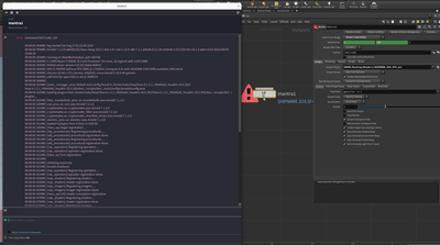

Hello!
I have Arnold installed and while Arnold works fine on it's own it completely stops Mantra from writing any images to disk. I am using both of these render engines for my work so this is a big issue for me at the moment having to uninstall Arnold each time I want to use Mantra for anything. I tried removing every single plug-in and I am getting the same Arnold-errors each time I have it installed.
This is the error message I keep getting each time I try to render anything with Mantra when Arnold is installed:
Command Exit Code: 134

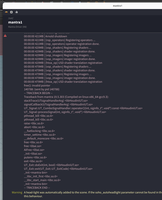

free(): invalid pointer
136232: (sent by pid 136232)
-- TRACEBACK BEGIN --
Traceback from mantra 19.5.303 (Compiled on linux-x86_64-gcc9.3):
stackTrace(UTsignalHandlerArg) <libHoudiniUT.so>
signalCallback(UTsignalHandlerArg) <libHoudiniUT.so>
UT_Signal::UT_ComboSignalHandler::operator()(int, siginfo_t*, void*) const <libHoudiniUT.so>
UT_Signal::processSignal(int, siginfo_t*, void*) <libHoudiniUT.so>
pthread_kill <libc.so.6>
raise <libc.so.6>
abort <libc.so.6>
__fsetlocking <libc.so.6>
timer_settime <libc.so.6>
__default_morecore <libc.so.6>
free <libc.so.6>
free <libai.so>
AiFree <libai.so>
_init <libai.so>
putenv <libc.so.6>
exit <libc.so.6>
UT_Exit::doExit(int, bool) <libHoudiniUT.so>
UT_Exit::exit(UT_Exit::UT_ExitCode) <libHoudiniUT.so>
_init <mantra-bin>
__libc_init_first <libc.so.6>
__libc_start_main <libc.so.6>
_init <mantra-bin>
-- TRACEBACK END --

What happens is that when I try to render anything with Mantra when Arnold is installed the render will fail ( Mantra IPR still works ).
When I close Houdini, flipbooks, Mplay the same crash message will be shown. Here is a crash file that is generated just from closing Houdini.
