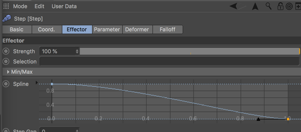

@Peter HorvathI've figured out how to distribute the colors in the right order from start to end. One just need to adjust/invert the spline of the the effector, as shown in the picture. And I've tested with images and it works. Perfect!!! Thanks again for your help.
