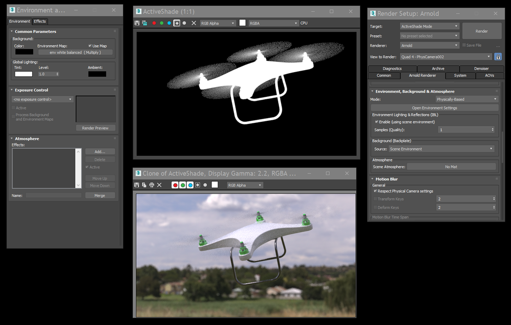

Is there a way for a skydome to be visible to the camera, but invisible to alpha? I want the skydome to render in the RGB channels, but alpha should be transparent. That's the way it works if I use the Environment dialog, which in turn creates an invisible Arnold skydome.
So it is possible to do this in Arnold, it just looks like the function is not exposed in the Arnold Light. Is that correct? If so, can we add an Alpha component in the Contribution rollout of the Arnold Light?

It's not possible in Arnold. Are you using Environment > Background > Environment Map?
That comes out as a background shader.

I beg your pardon, although it may not be possible in the Arnold core, it is absolutely happening in MAXtoA. See screen capture. The environment map is rendering in the RGB channels, but the alpha is transparent.
This is necessary in workflows where the background needs to be rendered, but the foreground and background need to be adjusted separately in post.

I don't think this is a skydome light though. If you export an ass file, options.background should be a shuffle shader, which links to a rayswitch.

Someone told me it was a skydome... it acts like a skydome. So maybe there's a rayswitch AND a skydome

The environment case works because what we do is exporting the selected map both as
- the skydome light color, with camera visibility off
- the background, with alpha overridden to 0 by a shuffle node.
For now I don't see a way to override the alpha with just a plain single skydome light.
