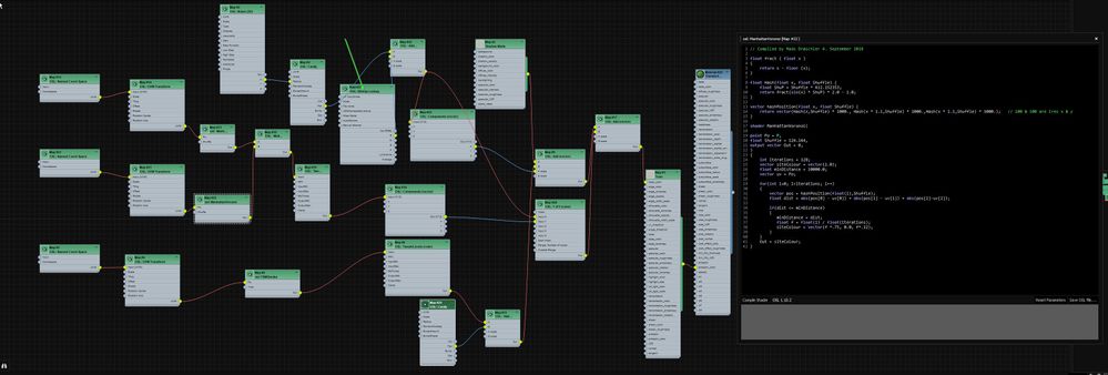

Attached a zip file with the max file and texture.
- You operate the "sun" like normal, change direction and the tracing of the shadow will follow, note angle is 0 on sun to avoid penumbra and increased edge size detection.
There are some mixing tricks in here, adding things into the shadows correctly and using things to bias inputs.
I added 2 custom OSL nodes, the manhattan voronoi and a FBM Smoke which helps producing certain artifacts.
The larger splats on the surfaces is generated with detecting spheres intersection with surface ( exactly like the mahnattan voronoi in a 3d field ) - and then distort their uniform looks with an irregular perlin noise.
I trust this covers most of the basics of the 3&4 shader.
Use the bitmap nodes scale to scale the texture, and use the UVW map modifier gizoms to move texture coords around to get different patterns going on misc assets.
With that I'll look at making JDisplacement look like a very unattractive and outdated application down the road.
( open the noodle fullscreen )
Note, all these nodes can be compiled down to just 2!
an arnold node, and a master Toon shader you just plug in? and EVERYTHING is set up completly automatically.
The power of OSL.
Note you can easily comp the layers, or overlay them, I put in both examples in the file, this way you can make the large splats either sit on top of everything, or simply just be added up and blend in, you got full control. that is up to you.
If you got some issues understanding the blending.
Well just say, then I can add in another OSL node that makes it very simple where we simply use a Layer node and stack all the bits and bobs like a photoshop documents.

holy sh*t - these nodes look frighteningly complicated! lol

You can disable segments and see how the things are added in while having Active shade running so you see changes live.
If you get completly stuck we can look at simplifying the noodle, we can put everything in a single node more or less.
