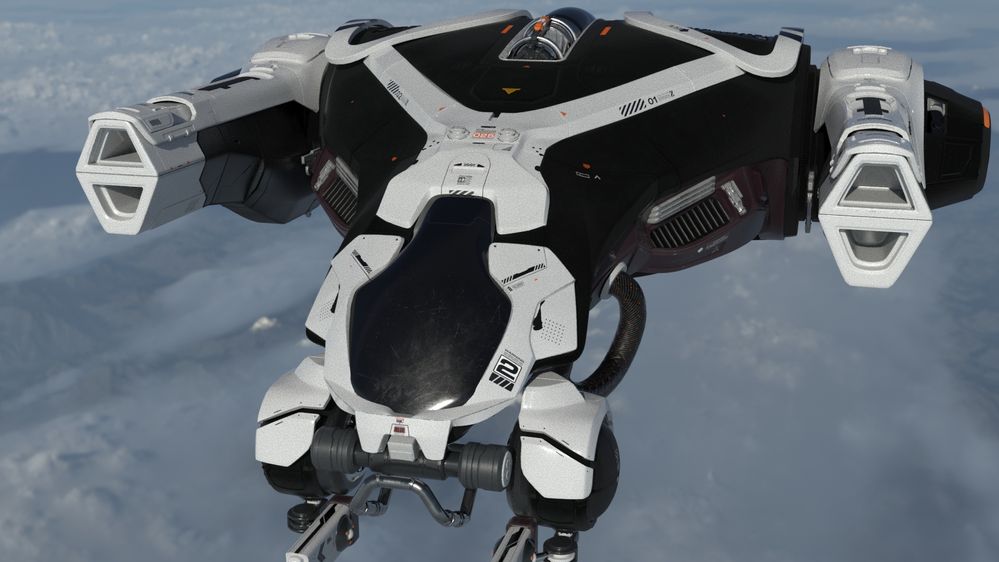

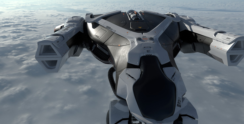

I have been searching all around and haven't found a solution to a couple problems that I am dealing with. Any help would be greatly appreciated.
1. I am having issue trying to use my displacement maps i had exported. What is happening when I use the Arnold Properties Mod it work some what but also inflates and expands the whole model in undesired places.
2. I am having problems with the metalness and specular roughness maps to come close to what I am seeing in substance painter, I'm losing alot of the subtle detail like the scratches and dirt I can only seem to get it to work on the glass portion of my model. I am using the same hdri map, tried using a color correct map with the gamma at 1.0 and Alpha is luminance checked, also tried using a Range map. Nothing seems to work.

The white and grey pieces shows a lot of grain, that could be from a faulty normal implementation or something else, so that would destroy any other stuff, including roughness.
Would really need to see your scene in detail, your map connections and so forth.

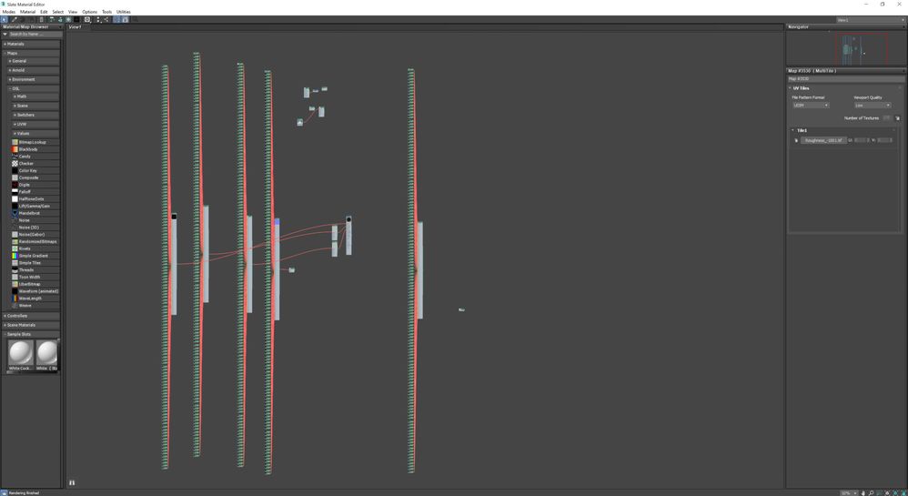

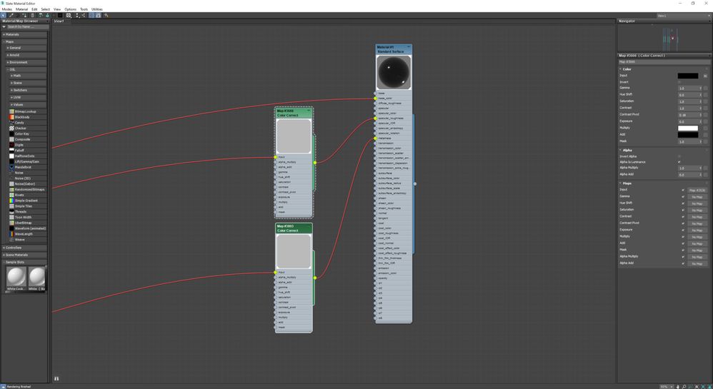

For this project I tried using UDIMs for the first time so I used a MultiTile to bring in all my maps. Here are some screen shots let me know if you need something more.

madsd
Bit hard to see.
Make sure your normals are working as the first thing.
Use the Legacy Normal node from max, not the Arnold one. It also shows in the viewport under HQ mode.
Also make sure you go by this info in general.
https://forums.autodesk.com/t5/3ds-max-shading-lighting-and/3dsmax-2018-arnold-how-to-get-multi-tile...
