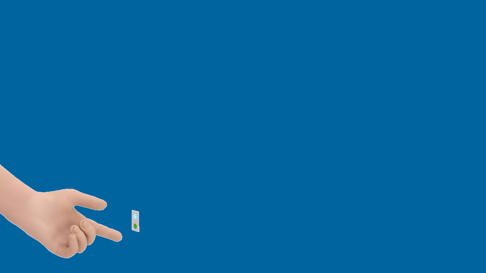

This is the scene :

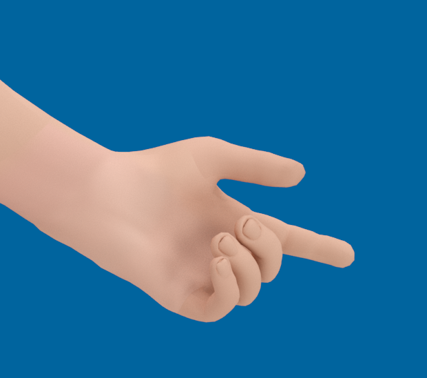

This is the foreground, the blue background is just there to show white border

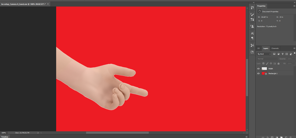

Try something like this.
My result in photoshop, the fringes has good integrity towards alpha.
Light comes from a hdri, and I just used the environment switch map, so I could put a pink color in the view background while still having light and shadows come from the actual hdri.
( you dont have these maps in 2019, so just do like you normally do )
Save to .exr format

Just add your hdri to environment directly and save out an .exr file, the file format is what is important, how you light it is not.
