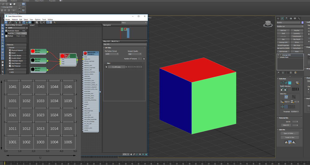

Unlike Maya MAXtoA has no dedicated UDIM token, nevertheless arnold supports udim mapping in max through the multi tile node, and apperantly through the arnold image node check the link for more infos, even though i havent tried that yet
here is a simple material setup using the multi tile node
Be sure to name your texturefiles accordingly
f.e.
diffuse_1001
diffuse_1002
diffuse_1011
Picture for the udim file pattern taken from here
https://area.autodesk.com/tutorials/displacement-mapping-using-the-udim-token/

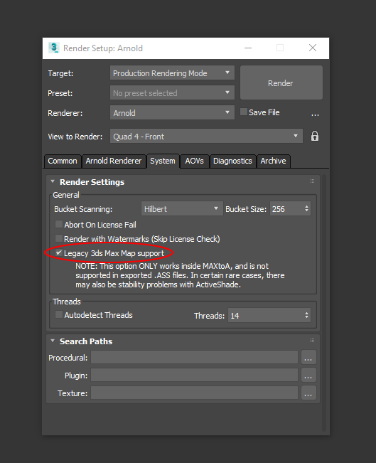

Nope i'm using max 2018 and MAXtoA 1.2.9.17 Do you have support for 3ds max legacy nodes active?
Youll have to make sure you enable legacy maps inside the system tab in the render settings so that arnold can actually use them

Thanks. I see the multi tile node now, but i wasnt able to get it to work yet.
i named my files COLOR_1001.jpg  and  COLOR_1002.jpg , but still cant see my second texture being applied to it/
ACCCC
in reply to: Anonymous
Make sure u set the multi tile node to udim, then try loading the texture using the 3ds max interface and not by manually creating a bitmap node and connecting it.
in reply to: ACCCC
thank you! it worked!
