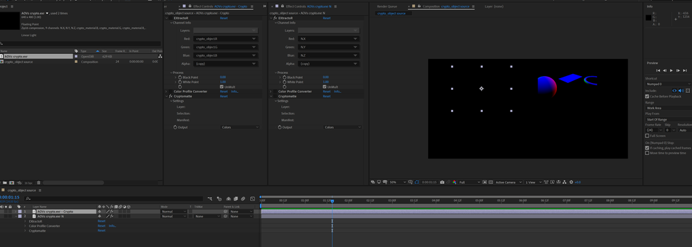

And in AfterFX:

Message 5 of 9
I indeed use max version 2020.3
Did you add the cryptomatte shader as I did? That's not visible from your screenshots.
Message 6 of 9
mpowers
I bet that is it. where did it go before MaxtoA 4.x.x
THANK YOU!

Message 7 of 9
It used to be underneath the aov section, you can see it in the documentation:
https://docs.arnoldrenderer.com/display/A5AF3DSUG/Cryptomatte
Now it has the same location, but the aov manager has a popup window.(the window in your screenshot)
So go to the render settings and the aov tab and there add the cryptomatte map to it like on my screenshot.
