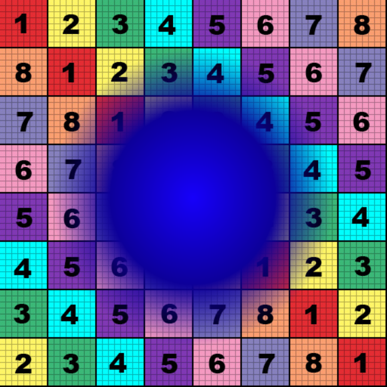

(I am newbie) I am looking for a solution to create a similar effect but without blowout from the object, only atmosphere blend.
Here is my problem:
as you can see I want to create green glow around gold objects. But using Arnold light mesh to gold objects (+arnold light decay) and creating new bigger (offset) object around them with volume (scattering is green), is giving me this, which is ok on black background but bad on brigther one as you can see those darker contour. How can I avoid those darker contours, I assume they are due to transparency of volume object cannot be absolute. I am using 2 additional lights but excluding them doesnt work.
- is there a way how to make object invisible for selected light sources (because I want the volume object to interact only with mesh light)?
I also tried emmision approach which didnt work, because it give me edges. And I couldnt find any simple way how to map opacity using gradient from the faces, for example?
Thank you in advance.

I am using proposed approach with mesh light on object inside of volume object. However, I dont want the bigger volume object interact with any other lights, because then I can see those darker areas. I am attaching simple example (image and 3dsmax19 file) of described situation. I used ligth decay to less then half of big sphere, so the outside blue shere edges can be seen, then inside is confined mesh light. volume_object_decay.zipvolume-object-decay.jpg
What I want is something (simple) like this image2365.png.
