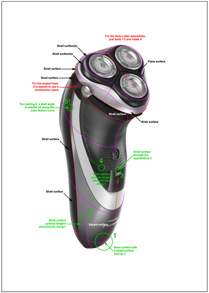

What I would say from professional and teaching experience alike is that the most important thing for novices (of any 3D software, really) is to figure out possible patch layouts - meaning to be able to decompose the form into its constituent parts. This could be done by sketches or taking good photographs or a scale mock-up to then simply draw possible surface boundaries on it, before fiddling aimlessly in software right away. See the two images attached (consumer goods). Once a credible patch layout has been identified, starting and commencing in 3D is fairly straightforward, because you know "where things should go".
Good luck with your project!
