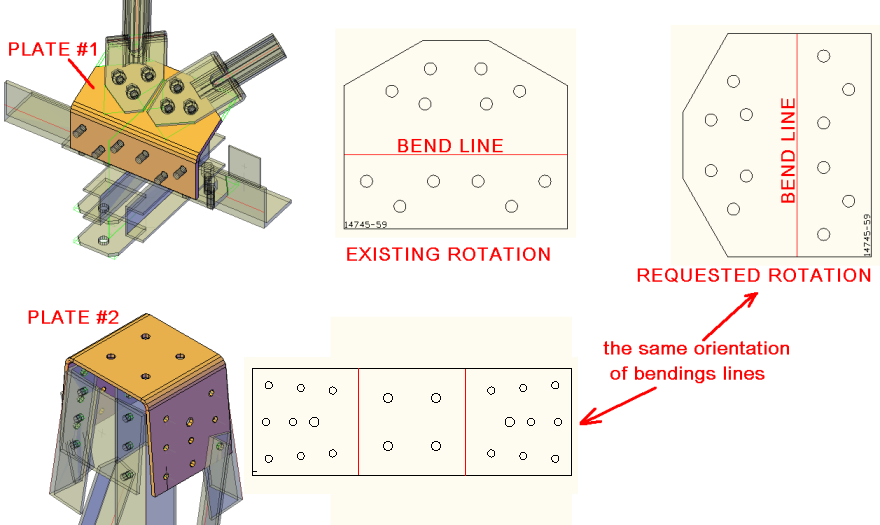

The production people require that the folded plates in the DSTV-NC file be rotated so that the bend line is perpendicular to the X direction. This is because they are usually made from sheet that is only rolled in 1 direction. For strength reasons it is good to have the bend line perpendicular to the bending direction.
If there are multiple bends, try to rotate the sheet so that the bend lines are perpendicular to the grain as much as possible (for example, 45° and 45° (between the grain of the sheet and the bend line)).
So we would need the ability to set the rotation of the folded plates in the DSTV-NC file.
See the sample picture
