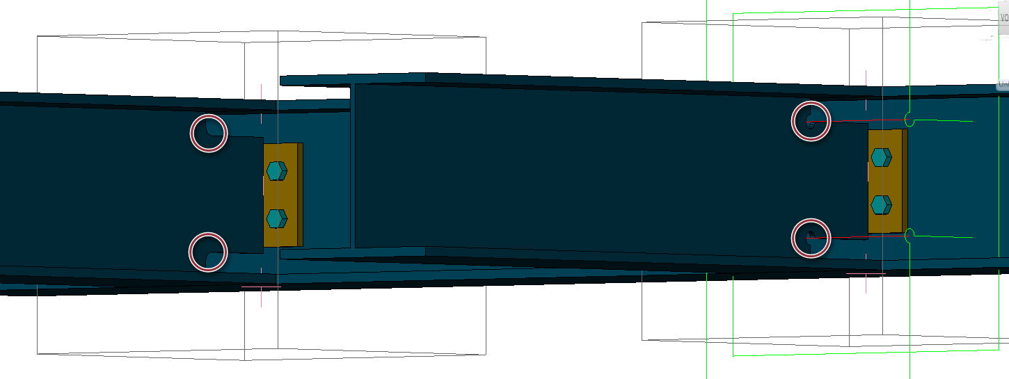

In all joints which use notches it should be possible to add different corner finishes,
e.g., instead of a radius a hole.
At the moment it is mostly only possible to use a radius.
However, holes can be easier produced.
If I liked to have a hole, I must leave out in the joint the notch and insert one or several manual notches with hole, in addition.
One can also build no bricks joint, because the parametric notch also does not contain this possibility.

Thanks for the idea. We will see how we can improve the joints modeling feature and take it in consideration for one of the future Advance Steel versions.
best regards
Udo

We are trying to enhance existing Joints through API, there is no feature in Advance Steel To upgrade Joints Functionality through Customizations.Problem is that We have to redevelop the whole Joint from scratch and test every conditions which takes long time Either All Joints need to have open source or otherwise need some extensions mechanism to do that Best Regards Sanjoy Nath
