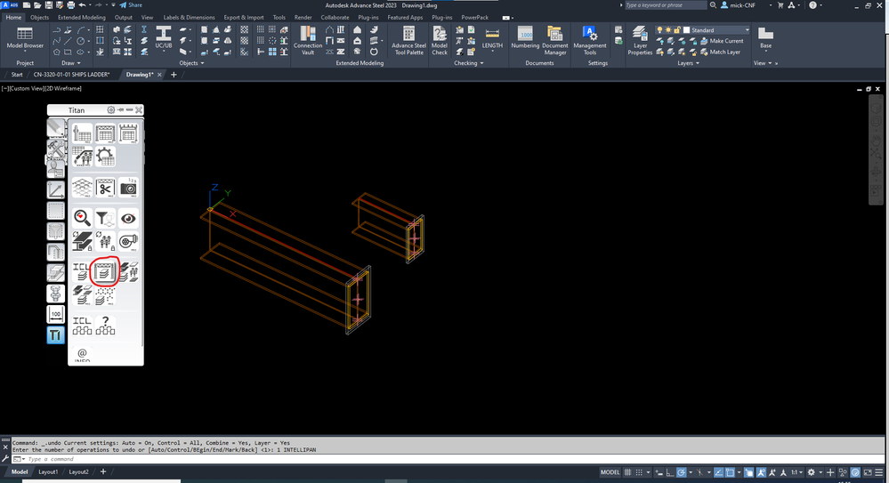

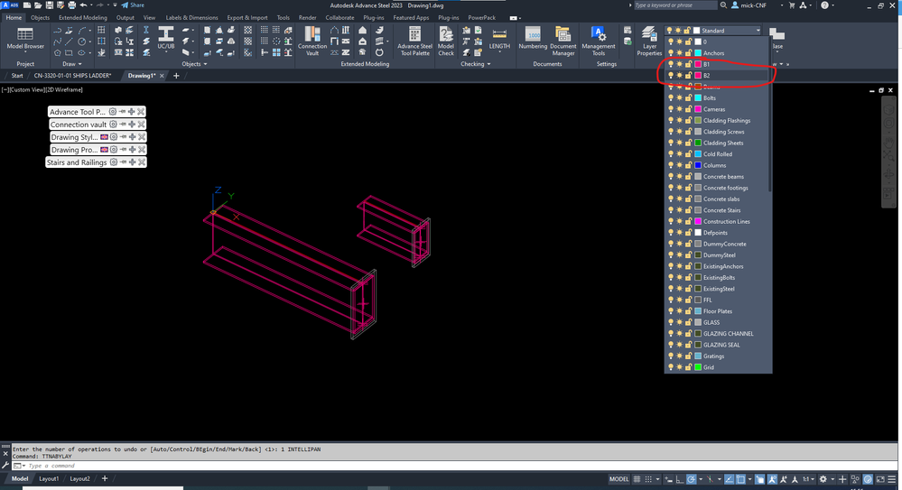

You can do this with the Titan add on demo version.
Screenshot 2022-08-08 155505.pngScreenshot 2022-08-08 155542.pngScreenshot 2022-08-08 155621.png
