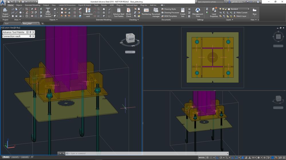

Currently when creating base plate with macro we do not have the option to manipulate the following parameters:
1. Grout thickness below leveling plate
2. Projection amount-top end of AB sticking above the t.o.concrete
3. If hooked-Hook size-developers-please make sure you know how the hook and the embedment is measured per AISC.
4. Number of nuts /washers/plate washers-sizes of plate washers/washers/nuts on bottom end
5. Number of washers/nuts below base plate
6. Number of washers/plate washers-sizes/nuts above base plate
We have the drawing style for AB elevation, but we are not able to model exactly what we want-does not make sence.
The way currently anchors are built in Astorbase is not working well. Even the anchor bolt names are entered  wrong by the developers.
There should be a macro to treat anchor as an anchor (round bar, theraded bar) and nut, washers and plate washers attached to it, manipulated from base plate macro and explodable in BOM.
Anchors shall be able to be detailed as MP with parts attached to them.

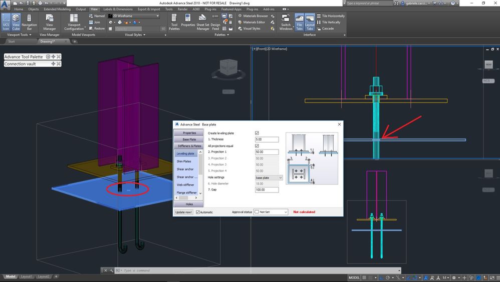

1) IMPORTANT FEATURE In this joint we can inser the "washer plates" only on one side. Please add the possibility to insert them upper, below or both sides. Please look the picture below.
2) CRITICAL ISSUE If the "Leveling plate" have a gap between the base plate major than the distances set on the anchors, the holes on the "leveling plates" disappers! Please look the picture below.
3) CRITICAL ISSUE If I insert the galvanised holes on the stiffeners, the macro create HOLES. These holes are nearest than the edge of the stiffener and conseguently the NC/DXF files are always wrong! These features could be as "Circular cuts" and not "Holes".
4) IMPORTANT FEATURE Insertion of the grout hole also on the leveling plate. Please look the picture below. This hole should have the same option than the grout hole for the base plate.
5) NICE IMPORTANT (USEFULL) FEATURE Insertion of some triangular shapes around the leveling plate contourn. They would be polycuts (not holes) .They would be insert by three options: At the middle of the edges of the leveling plates // At the middle of the flange/web of column // Offset from the middle of the edges of the leveling plate. Please look the picture below. When the builders put the leveling plates, they could be rotated and then create many problems later.
Please take care these request because they are very very important.
Thanks for understanding.
