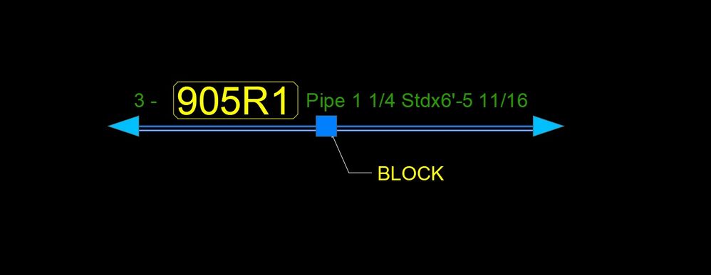

Bolts should be able to get numbering based on:
-Material
-Finish
-Diameter
-Length
These are state departments of transportation requirements, and it is nothing to do with weird fabricator's requirements. In other words, we cannot by-pass them.  Any help with this will be appreciated.

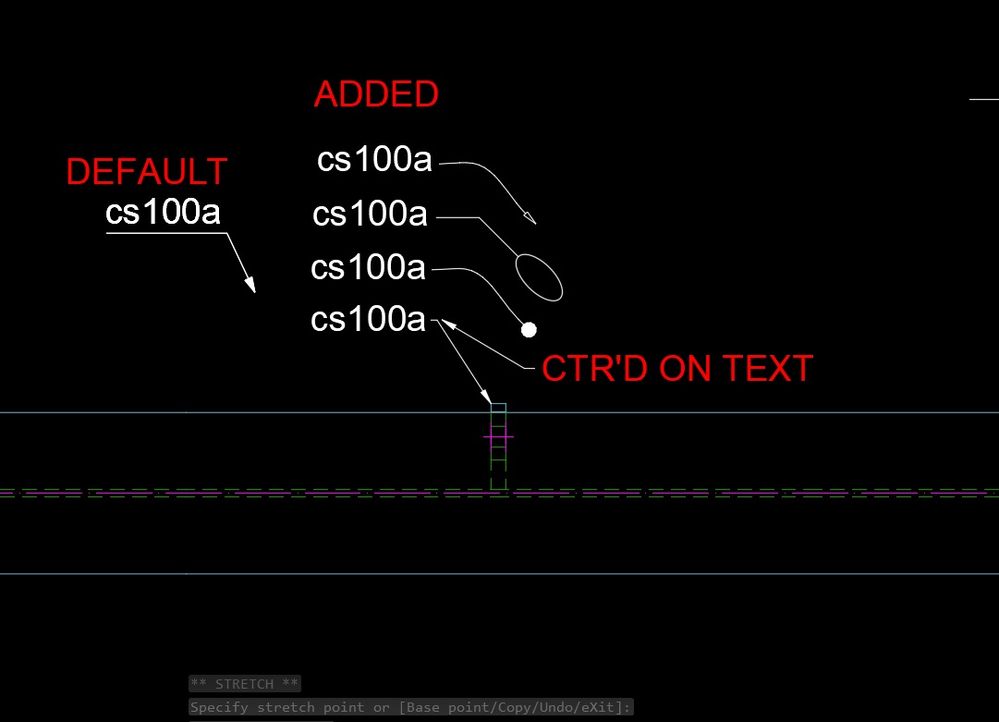

7. Leader for Labels to snap along contour lines of parts when moved manually
Aesthetics improvement and time saver:
 Leaders for labels for parts to snap along contour lines of parts, angle between leader and label to have 5 to 15 degrees increments, the length between leader point and break at the text to have 1/16" increments, and not overlapping other leaders and texts.

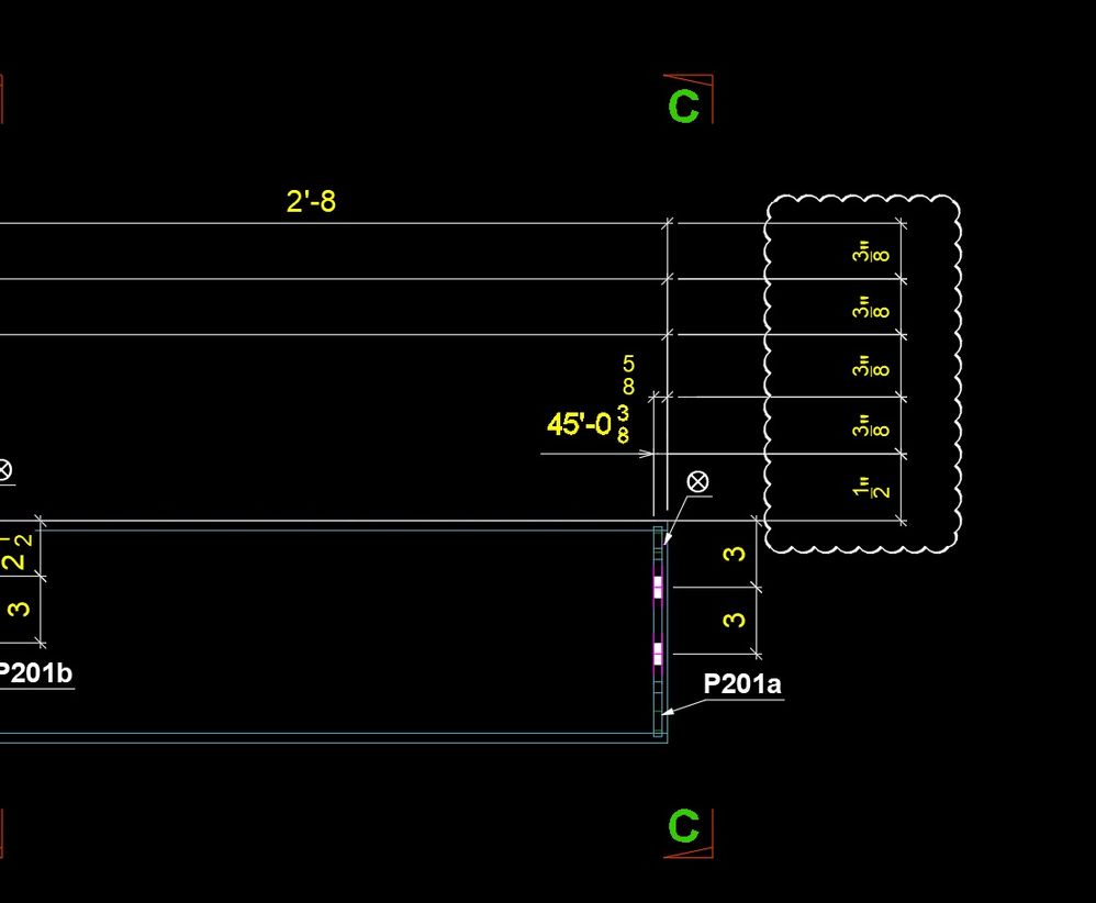

23. "Power dimensions" for contour lines not part of a macro.
Ref. 2 examples below, it will be a timesaver having power dimensions for contour lines only, holes eliminated, NOT connected to any notch, cut or hole macro.
Power dimensions to contour lines-notches.jpgPower dimensions-contour lines-platesPower dimensions to contour lines-notches-beams.jpgPower Dimensions-Contour Lines - Beams
23. "Power dimensions" for contour lines not part of a macro-added
A proposed method for selection of points to be added automatically-probably by "press and drag", left to right.
This way points that are not located along the contour line we want to dimension won't be selected:

31. Leader Styles for Labels
Per screenshot below-please add a possibility to control leader styles for labels similar to AutoCad, having one only leader and placing text always above the leader is less than what we need.
Leader Styles in Advance SteelLeader Styles in Advance Steel

32. Blocks within Labels and Detail Titles
Ref. screenshots below, it will be great if we had the option to include blocks within labels and also within detail titles:

33. Snap manually created or moved dimensions-1/2" from contour line, 3/8" between dimensions:
It will be a time saver if we had dimension chains snapping when manually moved / adjusted, or added new dimensions.
This will improve the aesthetics of the drawings.
