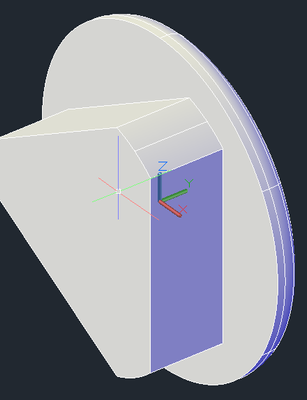

Just spent a decent amount of time converting manufacturer's dwg files to special parts so they can be inserted in the model.
Special parts such as base flanges for railings posts, wall brackets for handrails, Speedrail (R) parts, special bolts, nuts and washers, flanges for pipes, U-Bolts, anything that may come across-please share it here.
The attached file is in Imperial units,
Wagner Base Heavy Duty Flange Part 1623HD for 1-1/2" (1.9"OD) pipe, welded type
For those willing to share-Please make the text bold and underline when listing.
Thank you in advance and have a great day.

lowell.mcclain
Wagner #3418 2 1/2" CL Wall Bracket
May need a couple of little "fine-tuning" tweaks, but is modeled to the Wagner dimensions. It is also the same as the 1251R bracket, except the 1251R has two holes for screw attachment to the pipe. So a simple copy and rename will give you the 1251R bracket as well.
Message 11 of 20
acbsdesign
Re: WAG 3418:
Attached is the bracket positioned per UCS.
If this information was helpful, please use the Accept as Solution function, this makes it easier for other users.
