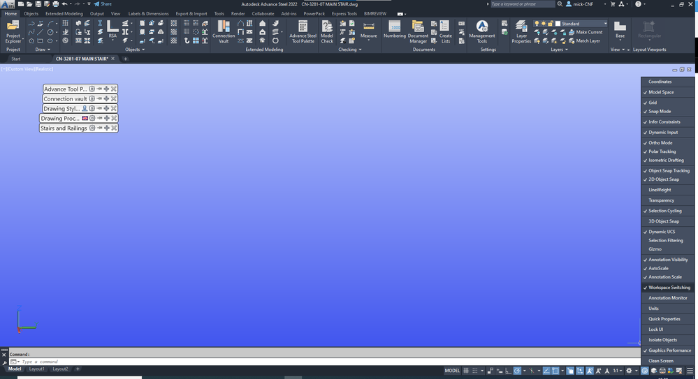

mick-CNF
Workspace settings bottom right, AS should be there. Tick always save.

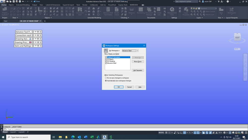

mick-CNF
Screenshot 2021-11-26 122920.pngScreenshot 2021-11-26 123021.pngScreenshot 2021-11-26 123117.png
If this information solves your problem please accept as a solution.

sabrimertbulut
I think that is the problem. because I cannot see at all advance steel button down there.

mick-CNF
Have you clicked the small down arrow?

mick-CNF
Then workspace settings.

sabrimertbulut
yeah the first photo that i send it you can see over there. Drafting annotation, 3d basics, 3d modelling but no advance steel
